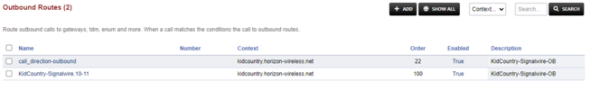

My outbound routes look like this:
Something's obviously wrong, but I've deleted and re-added a few times and same results.

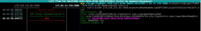

1,527
443
Your PBX should not be responding with a 407 Proxy Authentication Required, on an inbound from Signalwire. Check that you have the Signalwire IP addresses in your "Providers" ACL. If you edit the ACL remember to reload it.

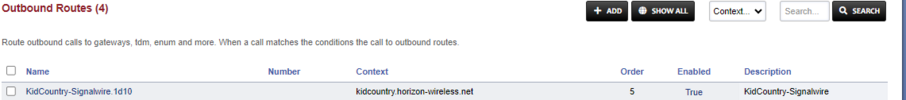

And here are my outbound routes Signalwire had me add:

Those are not the logs buddy. Nvm, looks like your problem is the order of your outbound dialplan entry. Is there a reason you changed it to 5 from default 100? Change it back to 100 and try again.
voipBull
Dec 3, 2023
111
24
If you look at your outbound dialplan, the first entry is a condition checking if the value of ${user_exits} is equal to 'false' or not. This variable ${user_exits} is evaluated and assigned a value in the top most dialplan "user_exits" (default Order 10), but because you've changed your outbound dialplan's order to 5, essentially making it the first dialplan to be evaluated before the variable ${user_exits} has any value, the first condition in your outbound dialplan evaluates to false and gets skipped over. I hope it makes sense to you.

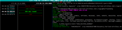

So from what I gather, dial plan is in the correct order and making progress. Now, it seems the call is hitting Signalwire, but they are responding with a 850 cause=1. The info I got from them was the call was not in E.164 format ... they are not getting the +1. I thought I had the dialplan figured out, but still doesn't seem to be adding the +1. Here's what I have: ^(?:\+1|1)?([2-9]\d{2}[2-9]\d{2}\d{4})$ I'm still learning my way into the dialplan structure but from everything I've read, that should be correct. I'm obviously missing something either in order of operations or structure. What would be the correct way to add a +1 ?
NVGcom
Apr 29, 2020
48
First of, FusionPBX/FreeSwitch are E.164 compliant.
FreeSwitch is part of SignalWire, so I have no clue why would anyone in their right mind from SignalWire tell you that.
The 850 error indicates that the called party cannot be reached because, although the called party number is in a valid format, it is not currently allocated aka assigned.
Do not fiddle about with Outbound Routes, as Adrian stated, if you are not acquainted with how FusionPBX/FreeSwitch works.
The dialplan does not "add" +1. It means it allows +1 to be sent out via caller if entered.
