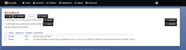

Here are some photos of what the web UI looks like.
