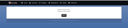

Destination will be one on call tech and alternate destination would be the other. Once all of this is setup you can add a blf button (or just manually dial the feature code) to toggle the enabled or disabled (Fusion calls it true or false in the above example). Does that make sense?
I am new to fusion but have an extensive background using freepbx. The concepts are the same so this should work for you. I was unsure what the extension field is for but maybe the documentation explains it in more detail.
The extension is one you just create like any other dialplan, ivr, ring group etc, just use a number that is not in use.
