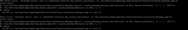

On Debian or Ubuntu you would run this then restart PHP FPM or restart the server.
apt-get install php-mbstring

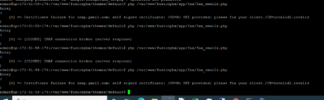

Here is the error that I am getting
If this is any indication that password is incorrect, then I have verified password and ports numbers.
mcs3ss2
Sep 8, 2020
290
AU
UPDATE - such a poor oversight by me, port number was incorrect (imap)
its working - yeaaaaaah

cheers @hisheeraz - this is my domain email, its with google workspace. yeah I already had less secure apps turned on, I re-enabled SSL and set it to true but trying both SSL and TLS got the below, I am going to try with an app specific password now

abov are the exact errors that I was getting when my fusion settings were not able to connect to imap

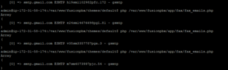

I see, I tried an app password same thing, I tried changing it to SMTP and I see this now
sent a test email to it but nothing happened, still tried some other imap settings.
I send out via a gsuite mailbox for fax to mail and voicemail and that works just fine, so strange

It cannot be smtp. My understanding is, fusion querries to mailbox inbox downloads email converts to fax and send as fax using t.38 protocol
fax to email is different, it is receiving fax and using smtp to send that fax to destined email
