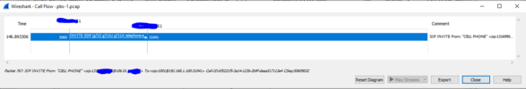

I went back and tweaked settings. There is no rhythm or rhyme to the ringing. I did a packet capture on two phones and exported the results of sngrep on FusionPBX.
Should the call ID found on the PBX also be found on the phone? I would think so but its not there on the phone side using sip.Call-ID == "value".
Assuming the call should be found, it's obviously not received by the phone being its not found and the PBX gets no response.
I have one GRP2616 that sits on my desk. As far as I have been able to tell, it doesn't have this issue. I thought I perhaps messed up the config of the FusionPBX domain somewhere so I tested with a different domain that has had no known issues with Poly/Yealink phones. These phones did not ring though the others did. I am super confused. Perhaps Friday I will go reset the phones once again but not apply any config - only SIP server and accounts. Maybe I am overlooking one of the few changes I am making as having an impact here.
