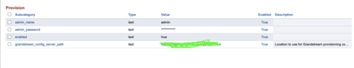

Hi guys, I am facing issues with auto provisioning Grandstream phones using fusion .when i provision the device with the server it works fine .but after provision my admin pass not working anymore.I set a password from Default settings of the system .but that password also not working .Can someone enlight me about this issue?

My first guess is you may not have reloaded default settings after setting a password and the phone might have set the MAC address as the password.
Try downloading the device's xml file and verify what is listed as the password.
Click on "Files" on the device page for phone in question. Once you select the <mac>.xml file it should prompt for the same credentials the phone uses for provisioning. Once downloaded search the xml file for "<P2>"

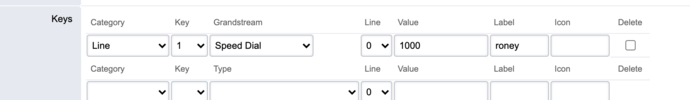

Hi thanks for ur reply .i resolved that .but now i am having issue with configuring Virtual multi purpose key from fusion server.I configured the Key in fusion but its not taking any effect on the device.

I mentioned in your other post, Key 1 is usually reserved for the active account. (typically account 1)
Key 2 and up work fine for other features.
