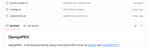

It picks the requirements file up from the application:
Unless you saw any errors from pip3 you should at least have a running web server.
