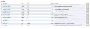

I'd like to be able to control the playing of time. date and caller ID when listening to a voicemail message. From my reading it looks like I do this "Advance - Variables" in the "Dialplan".
When I scroll to each of these locations I don't see the options to do this. The only settings I see are in "Advance - Default Settings" but they don't list what I'm looking for.
What am I missing? Thanks in advance for any help that can be provided.

Read the docs more closely. Those variables ultimately need to end up in the dial plan. They can be set globally in Advanced>Vars but that requires a freeswitch restart. The normal way would be to add an "action" "set" "<voicemail variable>=true in a domain or global level dial plan
