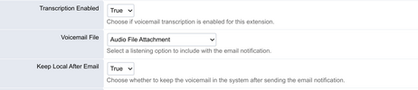

I got transcription working with OpenAI, but the first emails sent out do not have transcription in them, only the attached files. When I go to the messages via the web GUI, they are transcribed, and if I resend the email manually, the transcription IS in the email.

I have seen openai transcription in emails not be included far too often. The transcription does not seem to be returned quickly enough to be included in the email.

I figured it was timing. If only there were a way to delay the email composition.

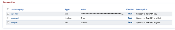

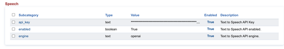

I am curious as to why there are two sections, speech and transcribe. In the speech resources, there exists both eleven labs and openai. In the transcribe resources, I see azure, google, openai and watson. Openai is the only one that is in both places.
Transcribe = speech to text
Speech= text to speech
Some services only provide 1 of these functions. Some functions use different settings (ex: API keys) if they provide both functions. There are more reasons why the services/applications are individualized.
It seems that the email needs to wait for the transcription payloads to be returned before sending.

Thanks. Hopefully a parameter can be added to delay the email composition once a wave file is recorded or OpenAI needs to be faster.

It makes sense now since the only one that is shown in both categories is OpenAI.
