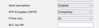

I have a Yealink phone (W60B) setup with TLS sip and mandatory SRTP mandatory.
The Yealink extension (201) has this dialstring assigned following guidance from documentation (tweaked),
{rtp_secure_media=true,sip_invite_domain=${domain_name},leg_timeout=${call_timeout},presence_id=${dialed_user}@${dialed_domain}}${sofia_contact(*/${dialed_user}@${dialed_domain})}

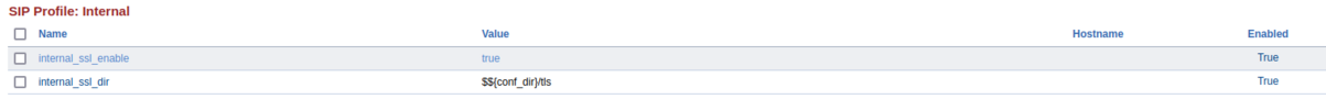

Let me ask what changes you made to your SIP profiles to get TLS set up. It's not configured out of the box. It is starting to look like freeswitch doesn't know how to apply SRTP
trumee
Oct 14, 2018
19
48
I have SSL enabled in variables with certificates in place,
The internal profile has default setting,
If i make a call to *97 from an extension, i do get crypto as the following screenshot and trace shows

Sure. Yealink phone is not necessary, any softphone will do too. I my case 201 is Yealink and 202 is Groundwire on Android.
Here is the setup:
1. Create two extensions say 201/202, and specify "{rtp_secure_media=true,sip_invite_domain=${domain_name},leg_timeout=${call_timeout},presence_id=${dialed_user}@${dialed_domain}}${sofia_contact(*/${dialed_user}@${dialed_domain})}" in its 'Dial String' definition.
2. Setup the clients to use TLS and SRTP.
3. Make a call between 201 and 202 and confirm SRTP is working.
4. Setup a Ring group with extension 600, and specify 201 and 202, and use Strategy 'Simultaneous'.
5. Setup Inbound Route Destination to 600 with "<action application="transfer" data="600 XML pbx.mydomain.com"/>"
6. Call 600 from extension 201 and notice it fail with "INCOMPATIBLE_DESTINATION"

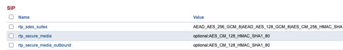

@pbxgeek Thanks you, your tips help me solve the problem.
This is the setup which works.
1. Setup the extensions 201 and 202 (without custom dial string)
2. Specify rtp_secure_media=optional:AES_CM_128_HMAC_SHA1_80 in variables
3. In groundwire sip app, Set Preferences>Security>SRTP>SDES, Enable only AES_CM_128_HMAC_SHA1_80
With this SRTP in ring group works!
I did not have to setup rtp_sdes_suites or rtp_secure_media_outbound. Infact if i setup rtp_sdes_suites i was getting an error. Can you post your setting in text form since the screenshot is not complete?

pbxgeek
Jan 19, 2021
121
51
37
Fantastic!
Here is my rtp_sdes_suites. But it's not a template. It may need some tweaking.
AEAD_AES_256_GCM_8|AEAD_AES_128_GCM_8|AES_CM_256_HMAC_SHA1_80|AES_CM_192_HMAC_SHA1_80|AES_CM_128_HMAC_SHA1_80|AES_CM_256_HMAC_SHA1_32|AES_CM_192_HMAC_SHA1_32|AES_CM_128_HMAC_SHA1_32|AES_CM_128_NULL_AUTH
