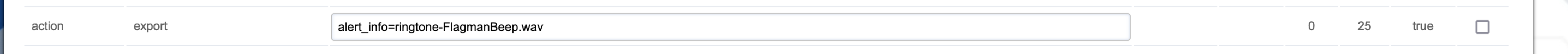

flagman
Dec 1, 2020
30
this works for me with yealink phones
action > export > alert_info=ringtone-Ring1.wav

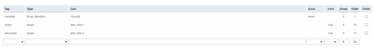

685
82
I've done it this way, just after the call direction is set. As the default provisioning templates set the Yealink alert_info strings, this works if FusionPBX provisioned the phones.
Thanks hfoster,
Yes this worked for me too with the yealink
("internal-extension" ringtone is defined on the handset)
