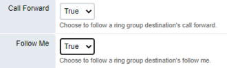

I have ring group which contains some extensions and also one external number, and the idea is that when "Ring group" receiving a call it will call to 2 extension and one outbound number simultaneously. And now the problem is that call is successfully going to external number, but internal extensions dropping after a second, so it cant initiate calls simultaneously. Can someone advise If I this is the right way, and maybe I should also enable something, to make it work.
P.S. In sequence strategy calls working great.

Is it possible one of your UA's is forwarding the call? If you are using the "simultaneous" strategy fs will blindly follow any redirect from the UA.
Have you tried "enterprise" origination? This will bridge each channel in a separate thread and ignore redirects. In my experience, this is usually the desired behavior.

You have that backwards.
Simultaneous will only dial the initial endpoints unless "Call forward" and/or "Follow Me" is set to true in Ring group.
Enterprise has always allowed for redirected calls since it uses multiple threads.
My guess is the external number is somehow telling Freeswitch the call has been "Answered" even though it may still only be ringing. This is common with using Analog trunks as gateways but I've seen a few SIP carriers send the wrong messages.

Ah, good catch. I always get the delimiters mixed up, should've looked that up before posting.
