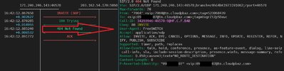

I am new to FusionPbx
I use FusionPbx 4.5.20 on Debian 10. My FusionPbx can make internal calls and receive calls from outside, but I can't make outbound calls. I have tried several methods but it still failed. Can you help me to solve this problem
My log:

I have attached pictures taken from sngrep

My issue has been resolved. I just changed the default value of ACL Lan to deny.
3,077
579
The reason you probably had the problem in the first place looks like you added entries to the ACL that you shouldn't have. The only thing that needs touching in the ACL is carrier IPs adding to domains ACL. That is it, nothing else at all.
