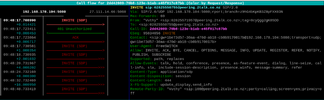

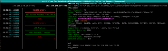

A SIP trace would be better to investigate your issue. We will be able to see the SIP response you got from the other side.

No. Time Source Destination Protocol Length Info
77 16:01:14 192.168.178.128 74.125.250.129 CLASSIC-STUN 62 Message: Binding Request
78 16:01:14 192.168.178.128 74.125.250.129 CLASSIC-STUN 62 Message: Binding Request
79 16:01:14 74.125.250.129 192.168.178.128 CLASSIC-STUN 74 Message: Binding Response
80 16:01:14 74.125.250.129 192.168.178.128 CLASSIC-STUN 74 Message: Binding Response
81 16:01:14 192.168.178.128 192.168.178.104 SIP/SDP 1279 Request: INVITE sip:02825550755@192.168.178.104 |
82 16:01:15 192.168.178.104 192.168.178.128 SIP 887 Status: 407 Proxy Authentication Required |
83 16:01:15 192.168.178.128 192.168.178.104 SIP 417 Request: ACK sip:02825550755@192.168.178.104 |
84 16:01:15 192.168.178.128 192.168.178.104 IPv4 1514 Fragmented IP protocol (proto=UDP 17, off=0, ID=5152) [Reassembled in #85]
85 16:01:15 192.168.178.128 192.168.178.104 SIP/SDP 79 Request: INVITE sip:02825550755@192.168.178.104 |
86 16:01:15 192.168.178.104 192.168.178.128 SIP 388 Status: 100 Trying |

Are both of these external outbound calls?
First screenshot: The beginning of communication looks good. You are sending an INVITE and the other side replies with 401 to authenticate. Are you using REGISTER instead of IP Authentication? It's OK if you do. Just want to make sure. After your second INVITE , which should have the authenticating info, the other side isn't answering. My best guess is that it never reaches them.
Second screenshot: The call didn't go through the external trunk, as it seems. It's showing a local IP.
Possible network or NAT issues on your end?

yes, I call to 02825550755

Oh, I got it. Same call with but two different legs. Makes more sense now. Well, after the call leaves your box the other side isn't responding. Hence why you keep resending the INVITEs. It could be an issue with resolving their IP address. Have you asked them to find these calls and see if they see anything past the initial INVITE? It can also be that they are sending a reply, but it's not making it back to you (NAT issue on your end)
You're right. How to configure NAT for local network ?
