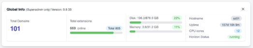

With FS PBX dashboard for FusionPBX you get this pop up when logged in as superadmin. This gives you inique number of extensions online. On registration page you often see multiple registrations per extension so the statistics may not be the most accurate.
Under each tenant dashboard you also have this information that gives you a nice overview
