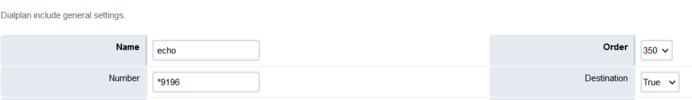

Is It possible add a IVR option that use a Dialplan Manager Entry?
Examples, in Dialplan Manager there is a entry like this:
echo *9196
Id like use this entry in the IVR.
Thank you

Solved: Create a new entry en Applications -> Bridges:
loopback/*9196
*9196 is the number to call a echo test; then add the entry to the IVR Options like:
option 4 nameofbridge order 003
SAVE and TEST

Easier: in Dialplan Manager, edit the echo *9196 dialplan. Change Destination to True. No need to create bridges or use Loopback.
