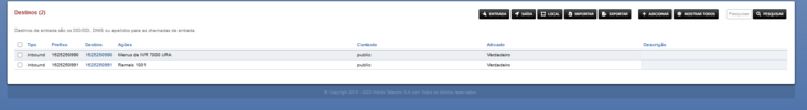

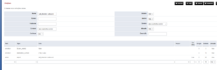

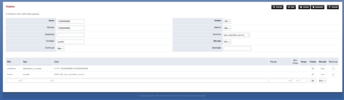

Hello everybody,
Could you help me with one question, yesterday the inbound route worked normally, today it is giving an error, 420 bad extension.
When a call arrives it is played on an IVR
