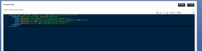

Also I have tried one weird approach to handle this but I don't know if this would work.
I modified one inbound XML to look for the number 0005975999 and then somehow modify the line
<action application="transfer" data="511901223001 XML 94.237.89.207"/>
to redirect the call internally, with this maybe I can replace the number 511901223001 with some variable that contains the called destination number and since there will be an inbound destination with that number it'll transfer the call?
Even for this I need a bit of your help @DigitalDaz because the above transfer condition doesn't work for inbound destinations, it's only working if I replace the number with a call center queue or conference room and then the next step will be to extract the number from some variable and use it there!!
is that something we can do ?
