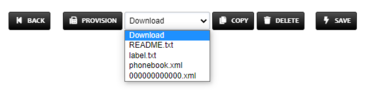

Also in case you didn't know, you can use the GUI to download the files for testing.
In top right of device edit page select "files"
Then click new dropdown to select the <mac>.xml
Assuming you have http_auth turned on, the we browser will prompt for credentials.

I have also tried downloading from the GUI and I get error "Unauthorized"
192.168.XX.XX - - [23/Jun/2021:03:23:16 -0600] "GET /app/provision/index.php?mac=aabbccddeeff&file={$mac}.xml&content_type=application/octet-stream HTTP/1.1" 401 13 "https://192.168.XX.XX/app/devices/device_edit.php?id=508de129-a352-4612-a12c-ea1c621e37a4" "Mozilla/5.0 (Windows NT 10.0; Win64; x64; rv:89.0) Gecko/20100101 Firefox/89.0"
