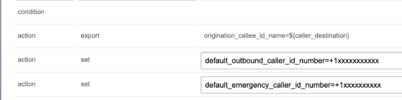

Hi to everybody,
i'm get stuck with outbound call, i've just added a gateway on my pbx, but after that inbound works perfect but outgoing still get rejected.
I've also tryed to erase all the outbound rules and rewrite them up but nothing change. Here some logs of the call.
