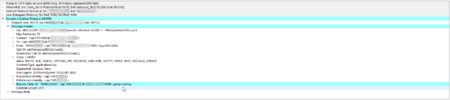

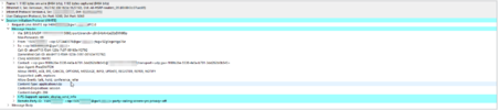

3CX is sending in the INVITE for an outbound call the CallerID 15051001000, FusionPBX it's accordingly receiving it, but it's not taking this to the INVITE that's sending to the Carrier for the outbound call, but instead it's sending the username of the Gateway SIP Trunk registration, which causes me the call to be sent with the CallerID.... of the username of Gateway SIP Trunk.
Here's the latest log from fs_cli:

I've bolded the line where I can see that FreeSwitch it's setting the CallerID to 57914385 instead of sending the CLID of the originating DID 15051001000.
I'm sending from the 3CX PBX the CallerID (the originating DID) in the FROM, RPID, PAID, PAI, but FreeSwitch feels like it needs to be adjusted with the SIP Trunk username....
Any ideeas?

Another update, at the time when I initially created the topic, I didn't prepare the PCAP's, but now I had a chance and I've reviewed he INVITE's, as they follow:
INVITE FROM 3CX PBX to FREESWITCH (FUSIONPBX):
INVITE FROM FREESWITCH (FUSIONPBX) TO THE CARRIER:
I've blurred out the essential data, but the main things that I observed are:
  • In the invite coming from 3CX PBX, I'm correctly sending via FROM, PAID, PPID & RPID the FROM DID, which should be displayed. I've used in my topic the DID 15051001000 as an example.
  • In the invite coming from FREESWITCH to the Carrier, I'm sending the CallerID (the DID that should be displayed) only in the RPID, because the FROM it's altered by Freeswitch to the user extension as it can be seen in the screenshot (second). The extension it's 5272443578. I left it unblurred in the screenshoot - the FROM field in the INVITE it's 5272443578@gw1.gateway.example when it should be 15051001000@gw1.gateway.example.
Please let me know if I can provide something else that might be relevant into solving this issue.
