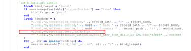

I'm losing my mind on this one, Trying to run a lua script when you press *8 in a call. I added my code to the array.
When I make the call, the the receiving phone does what's expected when you dial *2, *5 or *6 but when you press *8 it does not work.
Go over to the calling phone, press *2, *5 or *6 and nothing happens (expected) but if you dial *8 the lua script runs.

Looking over call_recording_on_demand the bind_target variable just gets used in the bind_digit_action a few lines down.
The bind_digit_action documentation page is burned into my second monitor I have looked at it some much.
figured it out the hello was 1 to many parameters. Though I could pass multiple into the lua script
Good catch. I would add the action to a dialplan instead of where you have in your screenshot.
