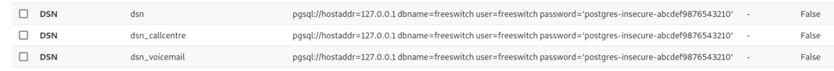

2. Three settings in Switch Variables (Admin->Switch->Switch Variables) for the DSNs were set to True, when by default, they should have been False. I have now corrected this is the DjangoPBX repo. The work around is to simply edit these three settings and set them to false, see the screen shot below:

2. Also saw them in one of my previous install tries, but identified them as some kind of install error, because the new DB password doesn't got sed'ed the right way. In my previous tries I corrected the password (without noticeable changes). Did a new install today, switched them to "false" and restarted freeswitch, but unfortunately without success.

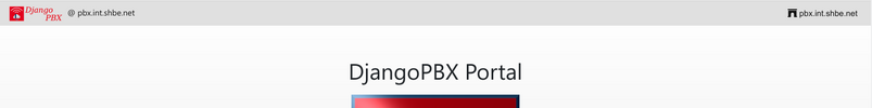

After my last install try, I can log into the DjangoPortal, but don't get the top "Portal" menue. Only the top bar with it's domain switcher. Once changeing the domain I get "Admin" and "Logout" as clickable text hrefs. Have had that already in past some times, but it's fully unclear to me why it's happen.
We probably should wait for other Freeswitch/Raspberry Pi user which are more clever than me ;-)

The menu is associated with the domain, so if your default domain did not get set up correctly or your login user is not associated with a domain, then you will not see a menu. See menu default below:
Hm... which part do i miss?
But when I press "Portal" in the top right edge (in the screen before), I get this:
Quite thanks once more for your help!!

Ok, I can see you have the default menu set for the domain. The next thing I would check is that the default menu is loaded. In Admin->Portal check what you have in Menu and Menu Items.

Quite cool!
That's it!
Both have 0 entries. Will check the install script because I'm pretty sure that I pressed "y" for the "Load default menu" question.
