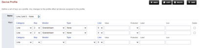

I think I found the none settings - I went to Devices>Profiles .. and then added a Line 2 and 3 and set it for none - ill find out for sure when I get to work tomorrow and see if those buttons are off on the phone. I do appreciate your guidance on this - I figured it was something easy but not knowing where to go or the wording, I was going off on another trail to find things. Once this hurdle is done, then i'll have to add a outside phone number to the PBX and see if I can figure that out. Thank you again for the guidance. If below is not the right place, feel free to smack me and let me know. :)
887
197
That looks correct. You also need to set which profile to use on the device setting page.
it has been a while since we used 2135’s but I seem to remember some firmware versions needed at least 2 of the buttons set as “default” or “line” to allow call transfer to work correctly. It might not be an issue anymore.

Profiles don't match up to anything by themselves. They can also be considered their own template of sorts. Profiles just make it easier to assign the same settings to multiple devices instead of entering the same fields under each device.
For a device to use the settings in a profile, it has to be selected in the device edit page.
